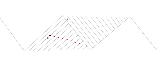

The following argument uses the compactness of $I$ in a way different from that used in the 'lemma' of problem 0.5 of the book.
To show that the entire space $Y$ cannot deformation retract to any point $x\in Y$, consider a sequence of points $x_{n}\rightarrow x,$ with each point $x_{n}$ being in a unique distinct strand (the red dots in the figure are supposed to represent the points of the sequence $x_{n}$).
If $Y$ deformation retracts to $x\in Y$, there is a continuous path from $x_{n}$ to $x$, for each $n\geq 0 $. Each such path has to pass through the point $B$ at least once. (if you remove the point $B$ from $Y$, then $x_{n}$ and $x$ are in two distinct path components, hence there cannot exist any path between the two points avoiding $B$).
Given $n$, consider the 'time' $t_{n}$ when $x_{n}$ is first mapped to the point $B$. Then consider the sequence $(x_{n},t_{n})\in Y\times I$. Because $I$ is sequentially compact, we have a converging subsequence $t_{n_{i}}\rightarrow t\in I$. Then $(x_{n_{i}},t_{n_{i}})\rightarrow (x,t)$. Let $F:Y\times I\rightarrow Y$ be the continuous map that gives the deformation retraction. Then the sequence lemma implies $F(x_{n_{i}},t_{n_{i}})\rightarrow F(x,t)$. This is a contradiction as $F(x_{n_{i}},t_{n_{i}})=B \ \forall n_{i}\geq 0$ as constructed, and $F(x,t)=x$, because it is a deformation retraction.
A similar argument can be applied to points $z\in Z$, to show both the facts that there is no def. retraction of $Y$ to $Z$, nor one from $Y$ to $z$.
