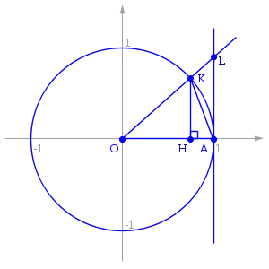

to prove the differential of sin(x) is achieved using the fact that $$\lim_{x \rightarrow 0} \frac{sin(x)}{x} = 1$$ to prove that we say that for a small enough absoulte(x) $$sin(x)\leq x \leq tan(x)$$ this is proved using a bit (complicated) geometry, that is only true assuming x is in radians. enter image description here
KH is sin(x)
the arc KA is x
and LA is tan(x)
this however is not a proof, the full proof is a bit more complicated.
