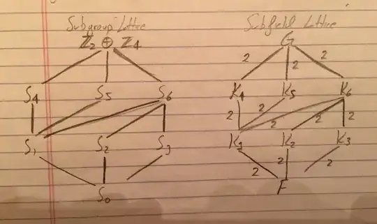

From the information I got, we can see that $\mathbb{Z}_2\oplus\mathbb{Z}_4$ has 3 subgroups of order 4 and 3 groups of order 2. Hence we have 6 subfields between $E$ and $F$. This result in the following lattice.
Am I on the right track? Would the approach be similar if the Galois group was isomorphic to $\mathbb{Z}_3\oplus\mathbb{Z}_4$? Would there be a faster way to find the subgroups of direct products?

Seems correct, based on a cursory reading of the subgroups, I will assume you have them correct, and refer you to this question for a complete description of the subgroups of a direct product. Subgroups of a direct product
I feel that I should point out that you have written $G$ at the top of your diagram for the fields rather than $E$. Also while this is a correct drawing of the lattice by the symmetry of the lattice itself, I feel that I should make certain that you are aware that $K_1$ does not correspond to $S_1$, but rather $S_6$, and $F$ corresponds to $\mathbb{Z}_2\oplus \mathbb{Z}_4$ rather than $S_0$ as is suggested by the way the diagrams have been drawn in parallel. If this was intentional, I mean no offense, just wished to point it out in case it wasn't.
jgon
  • 29,394
  • thank you for pointing these things out. If you don't mind me asking, why does $K_1$ correspond to $S_6$? And why does $F$ correspond to $\mathbb{Z}_2\times\mathbb{Z}_4$? Small details like this still confuse me here and there. Thank you once again for your help. It helps me a lot. – Kevin_H Apr 28 '15 at 06:25
    The subfield you get corresponds to the fixed field of the subgroup of the Galois group. So since $F$ is fixed by all the automorphisms in the Galois group, (and since the extension is Galois), the fixed field of the Galois group is $F$ and so the whole group $\mathbb{Z}_2\times\mathbb{Z}_4$ corresponds to $F$. In general small groups correspond to big fields, and vice versa. Since $K_1$ has dimension two over $F$, it corresponds to a group with index $2$ or size $4$ in the Galois group. Then since the diagram has to line up still, it must correspond to $S_6$. – jgon Apr 28 '15 at 06:31
    The reason the index should be 2, is that the Galois group of an intermediate field extension is the quotient of the Galois group $G$ of $K/F$ by the automorphisms that fix the intermediate field $L$. – jgon Apr 28 '15 at 06:32
