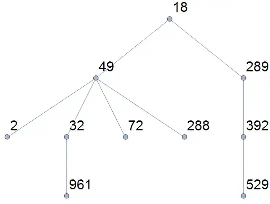

Examples: case $a=8:$
A straightforward brute-force search for $(8,b,c);\ (b,c)<1000$ gives triples
$(8,2,49),(8,8,49),(8,18,49),(8,18,289),(8,32,49),(8,32,961),(8,49,72),(8,49,288),(8,289,392),(8,392,529),$
where it is immediately apparent that the same numbers recur a number of times. Removing the $8$ and graphing shows the connectedness more clearly:

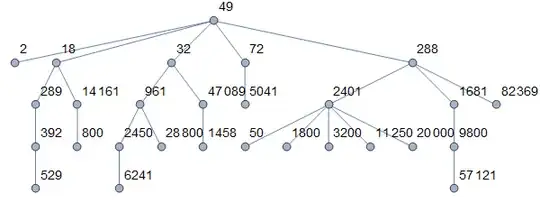

Searching for $c$ only, using the distinct elements from the initial search (eg $(8,49,c)$, etc.) up to $10^5$ reveals further connections:
$(8,49,c)$ for example turns up $6$ triplets: $(8,49,2),(8,49,8),(8,49,18),(8,49,32),(8,49,72),(8,49,288)$
It may be more pertinent to ask then, are there infinitely many triplets for fixed $a?$ Certainly where $a$ is square, this is the case, but it is less clear whether this is the case when it is not.
