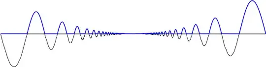

With the indicated definition of "piecewise", the answer is no: If $g$ is the zero function and $$ f(x) = \begin{cases} x^{2} \sin(1/x) & \text{if $x \neq 0$,} \\ 0 & \text{if $x = 0$,} \end{cases} $$ (which is well-known to be everywhere-differentiable), then their maximum, $$ \max(f, g)(x) = \frac{f(x) + \left|f(x)\right|}{2} $$ fails to be differentiable at each point $x$ with $\sin(1/x) = 0$, namely for $x_{n} = 1/(n\pi)$ with $n \neq 0$ an integer, since $f'(x_{n}) \neq 0 = g'(x_{n})$. (Vertical scale below exaggerated for clarity.)
A maximum of differentiable functions that is not piecewise-differentiable
Since the set of "corners", $$ E = \{1/(n\pi) : n \neq 0\}, $$ has $0$ as a limit point, $\max(f, g)$ is not piecewise-differentiable.
