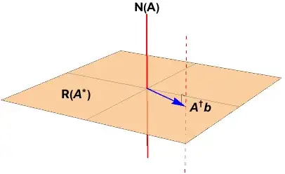

Given the matrix $ \mathbf{A} \in \mathbb{C}^{m\times n} $, and the data vector $b\in \mathbb{C}^{m}$ which is not in the null space $\color{red}{\mathcal{N}(\mathbf{A})}$, find the solution vector $x\in \mathbb{C}^{n}$, which minimizes the sums of the squares of the residual errors with respect to the $2-$norm $$ x_{LS} = \min_{x\in \mathbb{C}^{n}} \lVert \mathbf{A} x - b \rVert_{2}^{2} $$ This set of minimizers is, in general, an affine set and is depicted by the dashed red line in the figure below. The general solution to the least squares problem is $$ x_{LS} = \color{blue}{\mathbf{A}^{\dagger}b} + \color{red}{\left( \mathbf{I}_{n} - \mathbf{A}^{\dagger}\mathbf{A} \right)y}, \quad y \in \mathbb{C}^{n} $$ Vectors are colored to show they live in a $\color{blue}{range}$ space or a $\color{red}{null}$ space.
Every point on the dashed red line is a minimum. What are the lengths of these vectors? $$ \lVert x_{LS} \rVert_{2}^{2} = \lVert \color{blue}{\mathbf{A}^{\dagger}b} + \color{red}{\left( \mathbf{I}_{n} - \mathbf{A}^{\dagger}\mathbf{A} \right)y} = \lVert \color{blue}{\mathbf{A}^{\dagger}b}\rVert_{2}^{2} + \lVert \color{red}{\left( \mathbf{I}_{n} - \mathbf{A}^{\dagger}\mathbf{A} \right)y} \rVert_{2}^{2} $$ What is the solution vector of minimum length? Set $y$ to cancel the null space terms and we are left with $$ \color{blue}{x_{LS}} = \color{blue}{\mathbf{A}^{\dagger}b}, $$ the point where the locus of minimizers punctures $\color{blue}{\mathcal{R}(\mathbf{A}^{*})}$.
