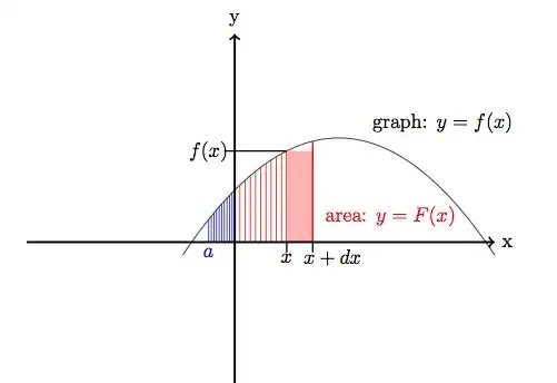

I hope that tis two pictures can help.
In the first is represented the area $F(x)$ under the graph of the function $y=f(x)$, starting from $x=0$. When we pass from a point $x$ to $x+dx$ the area increments of a quantity that is approximated by the pink rectangle, i.e. $f(x)dx=F(x+dx)-F(x)=dF(x)$. We can put this intuition in a rigorous statement using the limit notion, as: $$ \lim_{x \rightarrow 0}\dfrac{dF(x)}{dx}=\lim_{x \rightarrow 0}\dfrac{F(x+dx)-F(x)}{dx} =f(x). $$ And tis means that $f(x)$ is the derivative of $F(x)$.
Note that if we start from a point $a \ne 0$ the difference from the two areas is the blue area in the figure, that is a constant value $C$ , and this implies that we have a new primitive function of $f(x)$ : $G(x)=F(x)+C$, in accord with the fact that two functions that differ for a constant have the same derivative $f(x)$.

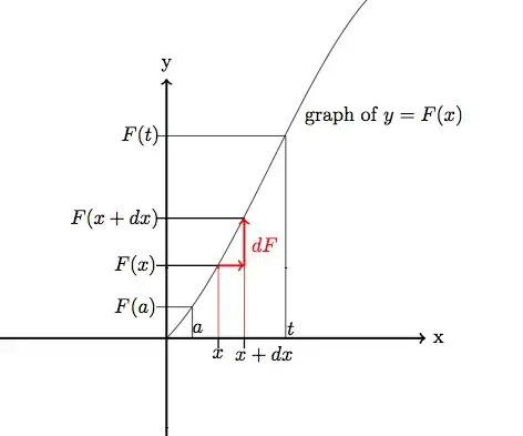

The second picture express the same result using the relation between a function and his derivative. Starting from $x=a$, where the value of the function is $F(a)$, we can reach the value of the function in $x=t$ adding increments $dF$ to any value $f(x)$ that we reach. This can be expressed as: $$ F(t)=F(a)+ \sum _a^t dF(x) $$
Now note that $dF(x)$ can be approximated as $dF(x)=F'(x)dx$, where $F'(x)$ is the derivative of $F(x)$ at the point $x$, and, using the limit , we have: $$ F(t)=F(a)+ \lim_{dx \rightarrow 0}\sum _a^t dF(x)=\int_a^t F'(x)dx $$
Note that, also in this case $F(t)$ is a primitive of a function $f(x)=F'(x)$ , defined less a constant $F(a)$.
