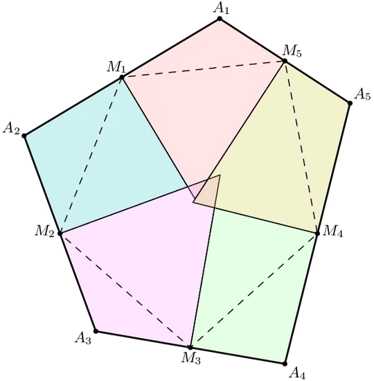

Dan Schwarz (one of the major problem proposers for EGMO, RMM, Balkan...) has posted a solution at here. I'll briefly sketch it here.
First, one takes the midpoints $M_1$, ..., $M_5$ of $A_1A_2$, ..., $A_5A_1$. Then at each angle $A_i$, one takes the circumcircle of triangle $M_{i-1}A_iM_{i+1}$ (which has radius $\frac 12 R_i$) and the point diametrically opposite $A_i$ on it, say $X_i$. This gives a quadrilateral $A_iA_{i-1}X_iA_{i+1}$, with area at most $(\frac 12 R_i)^2 \cdot 2\sin A_i$. Consider all five of these quadrilaterals, as shown.
Pentagon covering
It's not too hard to show that these five quadrilaterals cover the entire pentagon (look at perpendicular bisectors). So summing gives $$ S \le \frac{1}{2} \sum_i R_i^2 \sin A_i. $$ Then, by the Cauchy-Schwarz Inequality, we have $$ 4S^2 \le \left( \sum_i R_i^2 \sin A_i \right)^2 \le \left( \sum_i R_i^4 \right) \left( \sum_i \sin^2 A_i \right). $$ So it remains to show $$\sum_i \sin^2 A_i \le 5\sin^2 (108^{\circ})$$ reducing this to a purely algebraic problem (with $0^{\circ} \le A_i \le 180^{\circ}$ and $\sum A_i = 540^{\circ}$).
It's tempting to try and apply, say, Jensen's Inequality, but the function $\sin^2 x$ has a few inflection points, so one has to proceed more delicately using a fudging argument (along the lines of the $n-1$ equal-value trick). Indeed, we do this by showing that if $A_1 \le A_2 \le A_3 \le A_4 \le A_5$ and $A_1 < 108^{\circ}$, then we can replace $A_1$ with $108^{\circ}$ and $A_5$ by $A_1+A_5-108^{\circ}$ while increasing $\sum_i \sin^2 A_i$. Repeating this process until all $A_i$ are equal completes the proof.
