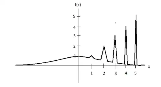

Let $f(x)$ consist of either a function whose improper integral over $\mathbb{R}$ is finite or triangular spikes.
Each triangular spike is centered at $x=n$ and has base $\frac 1{2^n}$ and height $n$. Thus, the area of the triangular spikes are $$A_{\text{spikes}}=\sum_{n=1}^\infty \frac 12 \left(\frac 1{2^n}\right)(n)=1.$$
Therefore, $$\int_\mathbb{R} f(x) \, dx \le A_{\text{function}}+A_{\text{spikes}}<\infty.$$ And $f : \mathbb{R} \to \mathbb{R}$ is continuous, positive, and has $\text{lim sup}_{x \to \infty} f(x)=\infty$.

We take the "tent" idea and, to make it positive, we make "elsewhere" into a convergent (yet positive) integral, e.g. $\frac{1}{n^2}$.
So define $f$ piecewise as follows for each $n \geq 1$:
On $[n, n + \frac{1}{2n^3}]$ it is a straight line going from $\frac{1}{n^2}$ to $n$
On $[n + \frac{1}{2n^3}, n + \frac{1}{n^3}$ it is a straight line from $n$ to $\frac{1}{(n + \frac{1}{n^3})^2}$
On $[n + \frac{1}{n^3}, n+1]$ it is just $\frac{1}{x^2}$.
And then on $[0,1]$ we have $f = 1$ and $f = e^x$ on $(- \infty, 0]$.
The integral is then convergent.
