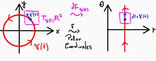

To illustrate this point, I will take an example from John Lee's introduction to riemannian manifolds. Consider a path $\gamma(t)=(\cos t,\sin t)$ in $\mathbb{R}^2$.
A circular path in standard coordinates, being mapped to a line in polar coordinates.
This path traces out a circle with constant velocity. You can truly calculate it's velocity $\gamma'(t)$. And if you were to change coordinates, say to Polar coordinates using a map $F$ getting a different path $\tilde{\gamma}(t)=F\circ\gamma(t)=(0,t)$, you could then map the velocity of this smooth path using $dF$.
This is in some sense what the derivative is, a map $dF$ that locally looks linear and tells you how to map velocities of smooth paths. But then what is the second derivative? It should be the acceleration of this path!
But while our path in the original coordinates clearly has an nonzero acceleration (centripetal) $\gamma''(t)=(-\cos t,-\sin t)$, in our second path it is zero $\tilde{\gamma}''(t)=(0,0)$. So there is no linear map relating both of them! The map $D^2$ you desired doesn't exist naturally!
