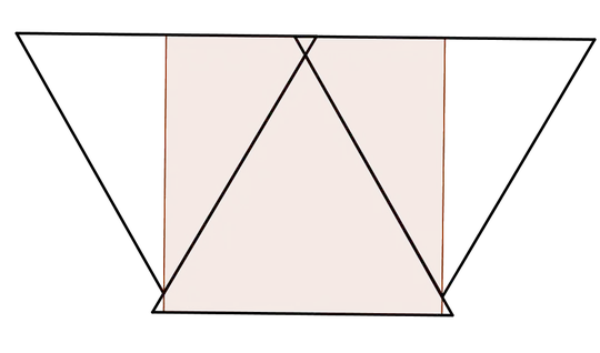

What is the minimum side-length $s$ such that three equilateral triangles with side-length $s$ cover a square with unit side length?
The existence of such an $s$ follows from a simple compactness argument. It is clear, from the previous question, that $1<s$ and it is easy to construct a cover of a square with equilateral triangles of sidelength $\frac{2\sqrt{3}}3$ as: enter image description here
It would not surprise me too much if $s=\frac{2\sqrt{3}}3$ - that is, if the altitude of the triangle had to be of unit length - but I cannot think of any reason to believe this.

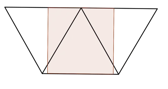

It has been pointed out in comments that the following configuration is better: enter image description here
The sidelength is $\frac{1}2\left[\frac{2\sqrt{3}}3+1\right]$.

    Take your figure and shrink the triangles. Move the outer triangles up the sides of the center one until the lower vertex is on the side of the square. For side $1$ the upper corners will be outside the outer triangles, but you should be able to calculate the triangle side where it will just cover. I can't imagine there is a better configuration, so you are there. – Ross Millikan Apr 07 '15 at 03:01
  • @RossMillikan I inserted a picture of what I think you're describing into my post; it's a pretty substantial improvement on what I thought $s$ would be (lying at the average of $1$ and my guess). – Milo Brandt Apr 07 '15 at 03:22
    You got my point correctly. The hard part of these problems is proving that there is not some different configuration with a smaller side length. In this case, it seems to me there aren't any other reasonable configurations, but it is hard to prove that. Three triangles don't give much flexibility in configuration. – Ross Millikan Apr 07 '15 at 03:25

Looking at the proposed configuration, we can find the minimum $s$ for that configuration as follows: notice how the two triangles on the sides overlap. This overlap is a smaller similar triangle (that is, it's equilateral), the larger that triangle is, the smaller $s$ is, so we seek to maximum the size of that triangle. We have the following equalities to work with: The sum of the altitudes of the big triangle in the middle, and the little triangle must be 1.
$A+a=1$
and the length of half a side of the large triangle minus the length of half a side of the small triangle must be 1/2
$\frac{S}{2}-\frac{s}{2}=\frac{1}{2}$.
This latter expression comes from the fact that the triangles on the sides are bisected by the vertical sides of the square.
We appear to have 4 variables, but since $a \propto s$, and $A \propto S$, we really only have two, and can solve this linear system easily enough (I leave the details to the reader).
