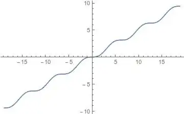

My first thoughts were that we would have to be careful about the domain of $f(w)$ so that the inverse was actually a function (and not a multi-valued function). But, on graphing $f(w)$ for various values of $t$, e.g. $t=1$ below, I think the domain can actually be $\mathbb{R}$.

Now, the problem is to find a reasonable guess; for given $t,z$, you could plot the function.
Let us take $t=1$ and $z=5$; the plot shows a root close to $w=10$. So, let us start iterating from $w_0=10$. The method then generates the following estimates : $9.70419$, $9.71440$, $9.71441$ which is the solution for six significant figures.
