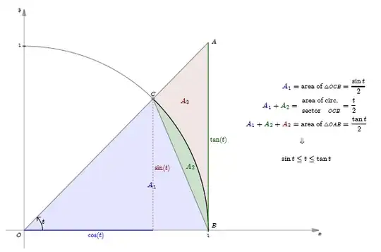

Recall (see the diagram below) that for $0\le t<{\pi\over2}$:
$$\tag{1} \sin t \le t \le \tan t. $$ Taking $t =\arctan x$ in $(1)$, we have, for $x>0$: $$ \sin\bigl(\arctan(x)\bigr)\le \arctan(x)\le x. $$ But $$ \sin\bigl(\arctan (x)\bigr) ={x\over \sqrt{1+x^2}}; $$ whence, for $x>0$: $$ {x\over \sqrt{1+x^2}}\le \arctan(x)\le x. $$ So, for $x>0$, we have $$ {1\over \sqrt{1+x^2}}\le {\arctan(x)\over x}\le 1; $$ and it follows from the Squeeze Theorem that $$ \lim_{x\rightarrow0^+} {\arctan(x)\over x}=1. $$

  • Nice diagram :-) It is pretty similar to this one. – robjohn Mar 18 '12 at 22:55
  • @David Mitra: Would you please say me how did you draw this diagramm? – Américo Tavares Mar 19 '12 at 18:01
  • @AméricoTavares using the Javascript library JSXgraph. If you like, I could link to the source. – David Mitra Mar 19 '12 at 18:03
  • @DavidMitra: Yes, please. Thanks for the information. I don't know whether I am able to install it, but I could try with the help of others. – Américo Tavares Mar 19 '12 at 18:08
  • @AméricoTavares The source for JSXgraph is at the link in my previous comment. The source to my diagram is here. JSXgraph allows you to make nice interactive diagrams; in the link I gave, you can click on and drag the point $C$ around (there are a few things I still need to do in the diagram, such as having the text $A_2$ move appropriately, and fix the highlighting). Please forgive my abysmally inefficient coding skills :) – David Mitra Mar 19 '12 at 18:15
  • @AméricoTavares You can actually use the library without having to install it. A copy of the Javascript file needed by the HTML page can be accessed by putting the line "" at in your HTML file. More details are at JSXgraph.org – David Mitra Mar 19 '12 at 18:20
  • @DavidMitra: Thanks again! – Américo Tavares Mar 19 '12 at 18:35
  • Dear David Mitra. Please help me how to draw a beautiful graph like you did? – impartialmale Mar 20 '12 at 09:33
