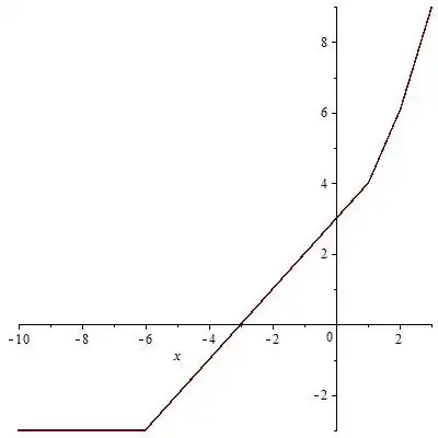

Now for using Maple. One way to plot graph of a Tropical polynomial (Graph of a function has an axis for the values of the function too!) and you can see the Tropical Variety on it too is as following.
For a one variable Tropical Variety, for example The tropical polynomial we computed at the beginning of our discussion, use the following Maple code;
> plot(max(-3, 3+x, 2+2*x, 3*x), x = -10 .. 3);
You will see the graph of this function, the y-axis represents $\max(-3, 3+x, 2+2x, 3x)$. For the Variety, pay attention that every term of our Tropical polynomial is a linear function and so its usual zeros are a linear subspace (here, line) and the places our Tropical polynomial attains its maximum in two terms are those places we have shrpness (singular points, or joins, collision, whatever you call them). So $V(Trop(p))={-6,1,2}$ , remember at above we defined our beginning polynomial with $p$ and so we showed its Tropicalization with $Trop(p)$. In the resulting image of Maple you may need to focus on the image at $x=2$ as its sharpness is a little. enter image description here

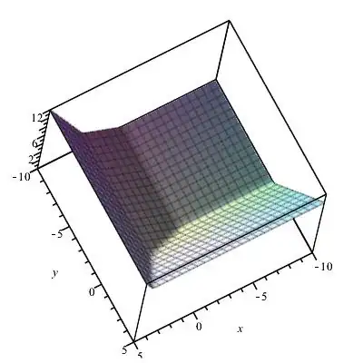

Now going to page 52, Of course I can't draw a general image for you using Maple with parameters $a,b,\cdots$ but we can draw for a given set of parameters to have an imagination. Of course you should do computations on hands for having shape of a family of Tropical varieties like the one is drawn at page 52.
I drew one for the Tropical polynomial $y^2+(-3)x^3+x+(-2)$, the result is not similar to the general photo given at page 52, maybe what you can see at my drawn image is part of the whole Tropical variety.
> plot3d(max(2*y, -3+3*x, x, -2), x = -10 .. 5, y = -10 .. 5)
Here you will see the graph of the Tropical polynomial which z-axis is the value. For seeing the variety, rotate the image and look at it from above (removing z-axis) and only save the sharp lines (I don't know how to ask Maple to only show the meeting sections of this faces). enter image description here
