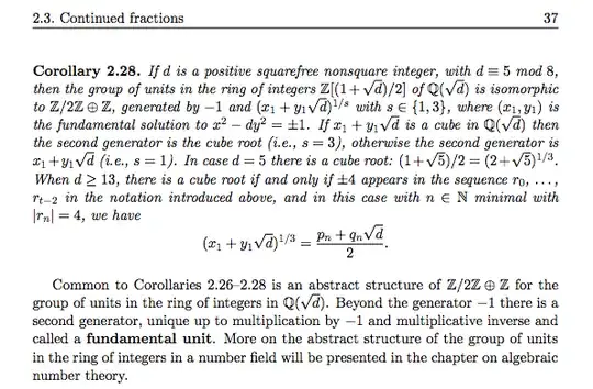

I have different corollaries for different numbers, the most appropriate for $141$ is the one below.

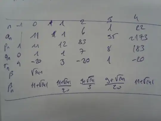

I used an algorithm (don't know if you know this, but
$\beta_0=\sqrt{141}+\lfloor\sqrt{141}\rfloor, \quad\beta_{n+1}=\frac{1}{\beta_n-\lfloor\beta_n\rfloor}$
$a_n=\lfloor\beta_n\rfloor$
$p_n=p_{n-1}a_n+p_{n-2}, \quad q_n=q_{n-1}a_n+q_{n-2} $) to determine the continued fraction expansion of $\sqrt{141}$
As you see the the sequence $(\beta_n)_n$ is periodic with period $t=3$ and thus $\sqrt{141}=[11;\overline{1, 6, 1, 22}]$, and $\pm4$ doesn't appear in the sequence $r_0,\dots,r_{t-2}$, so according to the corollary can I then assume that the fundamantel unit is also the fundamental solution, i.e. $95+8\sqrt{141}$ ?

$\sqrt{141}=[11,\overline{1,6,1,22}]$. Yes $95+8\sqrt{141}$ is a fundamental unit.
Proposition 19 says we need to check a few things:
  • $141 > (\pm 4)^2 + \frac{1}{2}(|\pm 4| + 1)$
  • Then $x^2 - 141y^2 = \pm 4$ appears as solution to continued fraction expansion to $\sqrt{141}$.
Since $\pm 4$ does not appear in your remainders, $x^2 - 141 y^2 = \pm 4$ does not have a solution. Therefore you just solve Pell equation with $r = 1$, which is guaranteed to happen by Propoisition 2.20
