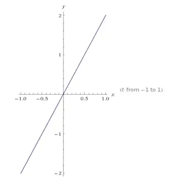

This is a plot of the line that passes through the origin and the point $(1,2)$, i.e. $(x,y) = t(1,2)$:
This is the line that passes through the origin and the point (1,2)

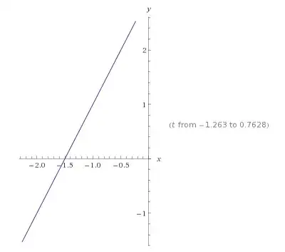

So then what does $\mathbf r_0$ do? It translates that line. Say you want the line which is parallel to the one given above, but which passes through the point $(-1,1)$, then the equation for it is just $(x,y) = (-1,1) + t(1,2)$. Here's the plot:
So to find the parametric form of the equation of a line you just need one vector (point) which represents the direction of the line -- I used $(1,2)$ in my example -- and one point on the line -- I used $(-1,1)$.
NOTE Your textbook may specify the parametric form as a set of scalar equations. That is exactly equivalent to as my vector equation above, just in a less compact form. In scalar form this second line would be $x=t-1$, $y=2t+1$. Can you see how this is exactly the same?

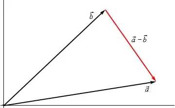

Let's consider the line passing through points $\vec a$ and $\vec b$ (I'm changing my notation so that it corresponds to this picture I found). Then clearly $\vec a - \vec b$ is a vector pointing in the direction of our line. See the picture here:
Now, what if instead of the vector $\vec a$, we just put $(x,y)$ -- which is some arbitrary point on our line. Then for $\vec b$ we could put in some specific point $(x_0, y_0)$ (where those would be filled in with numbers) on the line. Then if we had any vector orthogonal to our line, it would have to be orthogonal to $(x,y) - (x_0,y_0)$. So if we had such an orthogonal vector, it would completely specify the conditions that all $(x,y)$ must have to be on the line. Yay.
So let's see how to do it in the case of the line I gave you above (the one going through point $(-1,1)$ with direction vector $(1,2)$). Verify for yourself that an orthogonal vector to the direction vector $(1,2)$, is $(-2,1)$. Then we can just plug in: $\mathbf n \cdot (\mathbf r-\mathbf r_0)=(-2,1)\cdot((x,y)-(-1,1))=0$.
