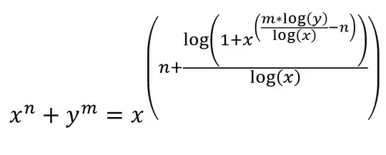

formula
I'm not sure what it's called or who discovered it, I just came across it.
hardmath
  • 37,715
Name
    In general you should cite your source ("I just came across it") and give an explanation. Otherwise it makes a fairly poor occasion for Readers to learn from what you write. – hardmath Jan 04 '16 at 15:20
    @hardmath It was discovered by a youtuber called GradeAUnderA, he has said that he still has the paper but it isn't on arXiv or anything like that. He also says it is a pretty bad proof which might not actually be right. – Nico A Jan 05 '16 at 11:52
  • Seriously? Its not self-explanatory? It's not a unique result and I'd expect most readers here to be able to verify it for themselves. Just... do it. $x^n + y^m = x^m + x^{\log_x y}=x^m(1 + x^{\frac {\log y}{\log x}})=....$ etc. – fleablood Nov 27 '16 at 17:44
