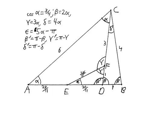

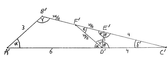

This question was prompted by rediscovering my common dissection of two very special rational triangles, the $4-5-6$ triangle and the $3-8-10$ triangle (both of area $\frac{15}{4}\sqrt{7}$):
4-5-6 triangle 3-8-10 triangle
All the lengths here can be shown straightforwardly with the law of sines and law of cosines; these triangles are a somewhat special case because so many of the angles involved are multiples of each other, but it seems likely that any rational triangle will inherently be special in somewhat similar ways.
