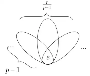

Similarly, except $N$, every $p$ subgroups of order $p$ in $G$ correspond to a same subgroup of order $p^2$. Let $s$ be the number of subgroups of order $p$ in $G$. Then $p\mid (s-1)$. Let $r$ be the number of elements of order $p$ in $G$. Note that $s=\frac{r}{p-1}$, as the following figure indicates.
Therefore, \begin{eqnarray*} p\mid (s-1)=\left(\frac{r}{p-1}-1\right) &\Rightarrow& p(p-1)\mid r-(p-1)\\ &\Rightarrow& p\mid r-p+1\\ &\Rightarrow& p\mid r+1 \end{eqnarray*}
