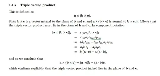

I understand where the $k$ comes from in $\varepsilon_{klm}$, however why do we need to introduce $l,m$ rather than continuing with $i,j$,
i.e $\varepsilon_{kij}b_ic_j$

Each time you have $2$ indices which are the same in the same term, there is an implied summation. This is known as the Einstein summation convention. So there are two reasons why we wouldn't want to use $i$ and $j$ for the indices on the second $\varepsilon$: $(1)$ we don't we to sum over each index of both $\varepsilon$'s (i.e. we don't want $\varepsilon_{ijk}\varepsilon_{kij} = \sum_i \sum_j\sum_k \varepsilon_{ijk}\varepsilon_{kij}$) and $(2)$ you are not allowed to have more than $2$ of the same index used in a single term because then the summation would become ambiguous.
For more information on the Einstein summation convention (though in a slightly different form) see the first part of my answer to this question.

Yes. It is necessary. You can't use the same indices. It's a different cross product. You already used $i$ and $j$ for the first cross product.
