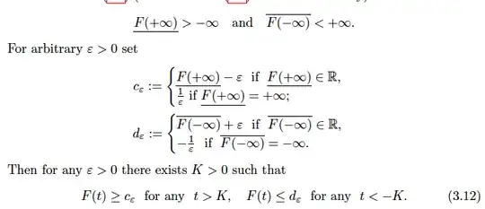

I have this part:
Where $$\underline{F(+\infty)}=\liminf_{x\rightarrow +\infty} F(x), \overline{F(-\infty)}=\limsup_{x\rightarrow-\infty} F(x)$$
My question is: How does property $(3.12)$ follow from the given information?
Thank you in advance.

  • I don't think your question is clear. The author chose to define $c_\epsilon$ and $d_\epsilon$ in order to make an interesting mathematical point. What is your question about property 3.12? Your wording isn't clear. – jdods Mar 09 '15 at 13:54
  • I don't understand why we have (3.12) – Vrouvrou Mar 09 '15 at 13:56
  • If you like, you could edit your question to state: "How does property 3.12 follow from the given information?" – jdods Mar 09 '15 at 14:00

Hint: If for some $\epsilon>0$ and for any $K>0$, $F(t)<c_\epsilon$ for some $t>K$, how could the $\liminf$ be larger than $c_\epsilon$?
More details:
Assume $\liminf_{x\rightarrow\infty} F(x)=\infty$ and there exists $\epsilon$ such that for any $K>0$, $F(t)<1/\epsilon=c_\epsilon$ for some $t>K$.
This means that no matter how far out you look towards positive infinity, there will always be an $x$ value such that $F(x)<1/\epsilon$, which is finite. Therefore, the limit infemum cannot possibly be infinite as there is always a larger $x$ value which gives a function output lower than $1/\epsilon$.
Similar arguments will work in the remaining 3 cases.

Let $F(x)=x$, so that $\liminf_{x\rightarrow+\infty} F(x)=+\infty$. Now fix $\epsilon$, say $\epsilon=1/10$. Therefore $c_\epsilon=2$. Now we can let $K$ be any number larger than $10$, thus for any $x>K$, $F(x)>c_\epsilon$.
Try to find the opposite of property 3.12 here. Can you find an $\epsilon$ such that $F(x)$ will always be smaller than $1/\epsilon$ if it is diverging to infinity?

  • I don't understand you – Vrouvrou Mar 09 '15 at 14:06
  • I've "negated" property 3.12. The definition of $\liminf$ requires the function to "go above" $\liminf$ eventually. $c_\epsilon$ is either an arbitrarily large number (if the $\liminf$ is infinity) or a number arbitrarily close, but below the $\liminf$ if it is finite. – jdods Mar 09 '15 at 14:10
  • $\liminf_{x\rightarrow+\infty} F(x)=\lim_{x\rightarrow +\infty} (\inf_{y\geq x} F(y))$ why you say there is always $x$ such that $F(x)<1/\varepsilon$ ? – Vrouvrou Mar 09 '15 at 14:19
  • I'm doing a proof by contradiction. I assume that property 3.12 does not hold and arrive at a contradiction, therefore property 3.12 must hold. – jdods Mar 09 '15 at 14:20
  • when $\liminf_{x\to +\infty} F(x)=x_0<\infty$ and $F(t)< x_0-\varepsilon$ where is the contradiction please – Vrouvrou Mar 09 '15 at 15:09
  • As x goes to infinity, there are always x values that are epsilon below the lim inf (for a fixed epsilon). That is a contradiction. – jdods Mar 09 '15 at 15:41
  • ah the contradiction is that there is a value small than the limite inf ? – Vrouvrou Mar 09 '15 at 15:46
  • Yes! Precisely! Do you see it now? – jdods Mar 09 '15 at 15:55
