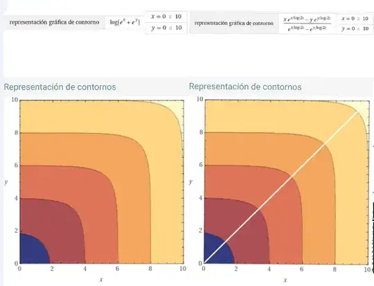

As @TravisWillse noted in his answer, for positive $\{x,\ y\}\gg 1$ you will have: $$\begin{array}{r c l} \ln(1+e^x+e^y)&\approx &\ln(e^x+e^y)\\ & = & x+\ln(1+e^{y-x}) \end{array}$$
from here you could do something different to better represent the function where $x\approx y$:
Working in other question I found this other approximation: $$\ln(1+e^x) \approx \begin{cases} \frac{x}{1-e^{-\frac{x}{\ln(2)}}},\quad x\neq 0\\ \ln(2),\quad x=0\end{cases}$$
For the last one the maximum error is below $0.0092$, and the plot is quite close:
comparison of the plots
Results that applying this to your problem leads to the following approximation for splitting the logarithm of the sum of exponentials LogSumExp(x,y): $$\ln(e^x+e^y) \approx \begin{cases} \displaystyle{\frac{xe^{\frac{x}{\ln(2)}}-ye^{\frac{y}{\ln(2)}}}{e^{\frac{x}{\ln(2)}}-e^{\frac{y}{\ln(2)}}}},\quad x\neq y\\ x+\ln(2),\quad x\equiv y\end{cases}$$
it works quite good if $e^x+e^y$ is not too close to zero.
comparison of formulas
