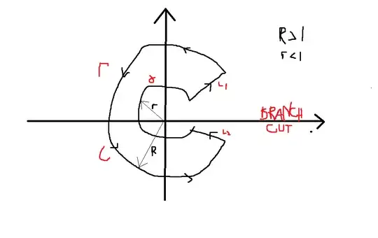

I need to evaluate the following real convergent improper integral using residue theory (vital that i use residue theory so other methods are not needed here) I also need to use the following contour (specifically a keyhole contour to exclude the branch cut):
$$\int_0^\infty \frac{\sqrt{x}}{x^3+1}\ \mathrm dx$$

Consider the integral of $\sqrt{z}/(z^3+1)$ around the given contour, using a branch of $\sqrt{z}$ with branch cut on the positive real axis. This can be evaluated using residues. Note that (in the appropriate limit) the integrals over $L_1$ and $L_2$ both approach $\int_0^\infty \frac{\sqrt{x}}{x^3+1}\ dx$ (for $L_2$ you're going from right to left, but also $\sqrt{z}$ approaches $-\sqrt{x}$ as $z$ approaches $x$ from below the branch cut). The integrals over the circular arcs should both go to $0$.
