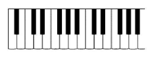

The division of the chromatic scale in $7$ natural notes (white keys in a piano) and $5$ accidental ones (black) seems a bit arbitrary to me.
Apparently, adjacent notes in a piano (including white or black) are always separated by a semitone. Why the distinction, then? Why not just have scales with $12$ notes? (apparently there's a musical scale called Swara that does just that)
I've asked several musician friends, but they lack the math skills to give me a valid answer. "Notes are like that because they are like that."
I need some mathematician with musical knowledge (or a musician with mathematical knowledge) to help me out with this.
Mathematically, is there any difference between white and black notes, or do we make the distinction for historical reasons only?

Start at F and go up a fifth (to C).
piano
(In a keyboard with 12-key octaves, that's 7 steps.) Repeat that process (through the circle of fifths). You'll hit all the white keys and then all the black keys -- F, C, G, D, A, E, B, F#, C#, G#, D#, A# -- note, these keys are usually represented with flats). So it turns out if you're splitting tones on 3 : 2 (fifth) or 4 : 3 (fourth), the least common multiple is twelve. In practice, the 3 : 2 is similar enough that it gives a sort of 'secure' or content feeling. The 4 : 3 gives a slightly edgier feeling but one which is somewhat counterposed perfectly against this secure feeling. So a fourth + a fifth will give you an octave. So why we want all twelve keys is that we're saying that we want the fifth (dominant) and the fourth (subdominant) to come together and make a whole. This is sort of mirrored with the fact that the first 7/12 of the circle of fifths form the basis and the second 5/12 are 'overlayed' on top (with black keys).
