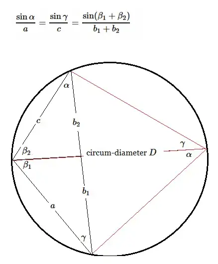

Draw a Circum-circle around the triangle and a diameter that passes through intersection of $a$ and $c$. Draw a cyclic quadrilateral including the endpoint of the diameter by joining lines of the triangle opposite to the given triangle.Mark angles $\alpha $ and $ \gamma$ in the opposite segment as shown.It is clear that for all positions of right side vertex $ \gamma+ \alpha $ which is constant on the arc
$$ \frac {\sin\alpha} {a}=\frac{\sin\gamma}{c} = \frac{\sin(\beta_1+\beta_2)}{(b_1+b_2)}= \frac{1} {CircumDiameter D} $$
is constant, the reciprocal diameter D.

  • I see the process sets up an acute triangle regardless whether the original triangle was acute, right, or obtuse. It is easy to satisfy the proof there. But the original triangle was obtuse. I know it works.. but thats just weird IMHO. – Chris Mar 03 '15 at 15:45
