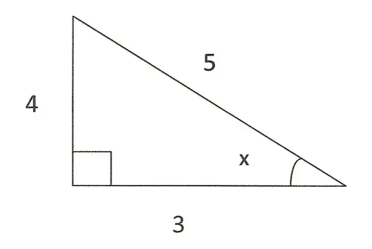

Your issue is your understanding of the relationship between your basic trigonometry values and the sides of a triangle. You must keep in mind that the values of trigonometric functions are utilising the sides of your triangles in the following manner: $\sin(x) = \frac{opp}{hyp}$, $\cos(x) = \frac{adj}{hyp}$, and $\tan(x) = \frac{\sin(x)}{\cos(x)}$.
Let us use your example of a $3$, $4$, $5$ triangle to prove our identities.
triangle, much wow Let us go ahead and figure out our values of $\cos(x)$, $\sin(x)$, and $\tan(x)$:
$$\sin(x) = \frac{4}{5}\\ \cos(x) = \frac{3}{5}\\ \tan(x) = \frac{\sin(x)}{\cos(x)} = \frac{\frac{4}{5}}{\frac{3}{5}} = \frac{4}{3}.$$
Now that we have figured out our values, we may plug them into our identities:
$$\sin^2(x) + \cos^2(x) = 1\\ \left(\frac{4}{5}\right)^2 + \left(\frac{3}{5}\right)^2 = 1\\ \frac{16}{25} + \frac{9}{25} = 1\\ \frac{25}{25} = 1$$
$$1 + \cot^2(x) = \csc^2(x)\\ 1 + \left(\frac{1}{\frac{4}{3}}\right)^2 = \left(\frac{1}{\frac{4}{5}}\right)^2\\ 1 + \left(\frac{3}{4}\right)^2 = \left(\frac{5}{4}\right)^2\\ 1 + \frac{9}{16} = \frac{25}{16}\\ \frac{16}{16} + \frac{9}{16} = \frac{25}{16}\\ \frac{25}{16} = \frac{25}{16}$$
