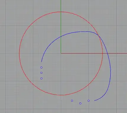

As with most questions where we want to keep from getting into deep arguements, it is a questions of how deep can we go? Here is what I came up with for a intuitive arguement:
First, we notice that we can embed (Put in so it doesn't really change) the cylinder $C$ into $\mathbb{R}^2$. Just think of sitting the cylinder on the table, putting your hands inside and pushing the sides down and out away from the center.
If the cylinder and Möbius strip were homeomoprhic, we could also embed it in the plane. But we cannot, and here is why:
Any map from the Möbius strip into the plane will not be injective, which means that (at least) two points will be sent to the same place, no matter what. Here is a Möbius strip, with the two sides identified.
And here is the same Möbius strip with two circles that only intersect once in the Möbius strip. (This is the important part.)
If we wanted to embed the Möbius strip, we would also embed the circles. So lets put the red circle in first, standardly, and the try to put in the blue circle.
We can see that blue circle should be on both sides of the red circle, but for that to happen, they must intersect each other twice! So, we can't embed the Möbius strip into the plane, hence, the cylinder and the Möbius strip are not homeomorphic.

  • Good answer. If I may ask, why should the blue circle be on both sides if the red, instead of tangent? – Christopher King Aug 18 '15 at 15:18
    This actually is where it goes a little "deep." The blue cirle is transverse to the red - Together they form a basis for the tangent space. Which means it must cross and not just be tangent. Great question though, I was trying to keep it simple in my answer, but this is important. – N. Owad Aug 18 '15 at 15:24
