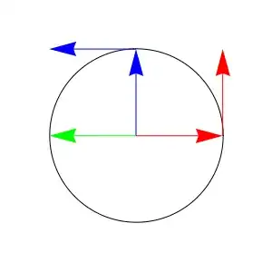

In the following animation, the red arrow inside the circle traces out $\gamma(t)=(\cos(t),\sin(t))$ and red arrow outside the circle shows the tangent to the circle at $\gamma(t)$.
The blue arrow inside the circle shows $\gamma^{\,\prime}(t)$, which is parallel to the tangent at $\gamma(t)$. The blue arrow outside the circle shows the tangent to the circle at $\gamma^{\,\prime}(t)$.
The green arrow shows $\gamma^{\,\prime\prime}(t)$, which is parallel to the tangent at $\gamma^{\,\prime}(t)$.
$\hspace{4cm}$harmonic motion
Note that the green arrow is pointed in precisely the opposite direction as the red arrow inside the circle. Thus, we have $\gamma^{\,\prime\prime}(t)=-\gamma(t)$. Therefore, $\cos^{\,\prime\prime}(t)=-\cos(t)$ and $\sin^{\,\prime\prime}(t)=-\sin(t)$.
Periodic functions can be broken down into circular components. This is the main idea behind Fourier Analysis. If one of the circular components has a larger amplitude than the others, the whole function appears essentially circular. In two dimensions, if the amplitude in one of the directions is larger, the motion will appear one-dimensional, but it is still harmonic motion, where $x''=-kx$.
At least to me, this is what makes the circular functions ($\sin$ and $\cos$) so special; in a way, they are the basic periodic functions.
