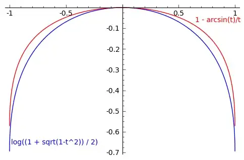

var('t')
#assume(t != 0)
G = plot(log( (1 + sqrt(1-t^2)) / 2 ), (t, -1, 1), color='blue')
G+= text('log((1 + sqrt(1-t^2)) / 2)', (-.6,-.65), color='blue')
G+= plot(      1 - arcsin(t)/t       , (t, -1, 1), color='red')
G+= text(     '1 - arcsin(t)/t'      , (.85,-.06), color='red')
G#.show(aspect_ratio=1)
In particular, the graph has a minimum of $-\ln2\approx-0.693147180559945$ at $\theta=\pm1$.
To check the endpoint, I computed an approximate numerical integral, which agrees with the above (the tuple gives the integral and error estimates):
numerical_integral(2*log(sin(x)), 0, pi/2)
$\left(-2.17758608788, 1.09713268507 \times 10^{-06}\right)$
