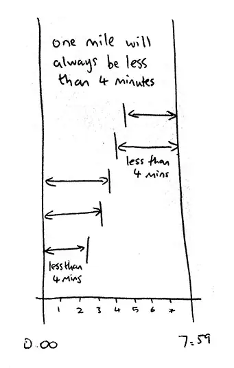

The way you argue with these people is with pretty pictures.
You can prove a stronger result: Either the first or the second mile of the race was run in under four minutes.
