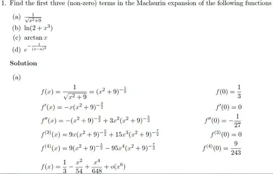

For (a) I tried using a shortcut, and rewrote $1/\sqrt{x^2+9}$ as follows:
$(x^2+9)^{-1/2} = [1+(8+x^2)]^{-1/2}$ Then I used the known Maclaurin expansion for $(1+x)^{\alpha} = 1 + \alpha x + (\alpha(\alpha-1)x^2) 1/2! + ... + $ using $\alpha = -0.5$ and $x = 8+x^2$ .
I got completely different results from the answer. What am I doing wrong here?
nofe
  • 1,025
    What is the radius of convergence of your starting series? – David Mitra Feb 24 '12 at 18:36
    You are not expanding about $x=0$. What's worse, your series will not converge. Try $(1/3)(1+(x/3)^2)^{-1/2}$, it will work out fine. – André Nicolas Feb 24 '12 at 18:37
  • what do you mean? isn't a maclaurin expansion always expanded about $x=0$ ? – nofe Feb 24 '12 at 18:39
  • @nofe: Yes, but $8+x^2$ is nowhere near $0$. If you use the expansion of $(1+u)^{-1/2}$, as you did, you are taking $u=8+x^2$! Use the alternate rewrite I suggested above. – André Nicolas Feb 24 '12 at 18:43
  • why must it be close to $0$ ? – nofe Feb 24 '12 at 18:46
    @nofe: The MacLaurin series for $(1+u)^{-1/2}$ that you substituted into only converges when $|u|<1$. By the way, if you want to send a message to me, it is best to begin it as I did this message. It is only by accident that I looked at this question again, and was not notified of a message. – André Nicolas Feb 24 '12 at 18:51
  • @nofe By definition, the Mc Laurin series expands the function at $x=0$. – Pedro Feb 24 '12 at 18:58
  • @AndréNicolas I got it, thanks a lot. – nofe Feb 24 '12 at 18:59
