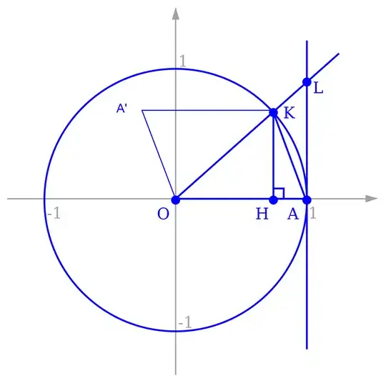

let $$\widehat{KOA}=x$$ the area of parallel sides kA'OA $=\sin x$
the area of Circular sector $=\frac{1}{2}x$
so you can see that the area of Circular sector < the area of parallel sides
$$\Rightarrow\sin x >\frac{1}{2}x $$
- 5,991
3I think this becomes a little more obvious if we use $AK$ rather than $OK$ as the diagonal of the parallelogram, so that the parallelogram completely contains the circular sector. – David K Jan 30 '15 at 13:57

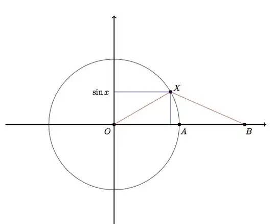

From the figure:
Arc$(AX)=x \Rightarrow $ area-sector$(OAX)=x/2$
$ AB=OA=1 \Rightarrow $ area-triangle$(OXB)= \sin x$.
So we can simply see the statement.
- 64,377
