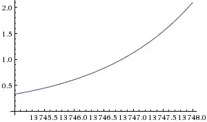

Yes. Expontentials will always squash powers. Do solve 2^x=x^1000 on WA and it will return the approximate form $x\approx 13746.8$. Now input plot 2^x / x^1000 from x=13745 to x=13748:
$\hskip 2in$ picture
You can see clearly that it goes from $\le1$ to $\ge1$ in this interval, so this is where $2^x$ overtakes $x^{1000}$.
