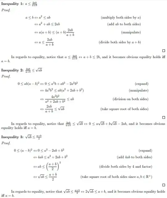

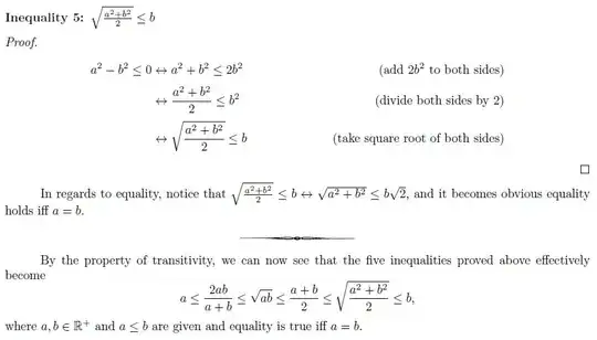

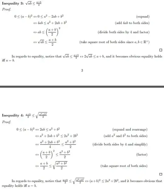

I am going to show you, via screenshots (too much effort to try to typeset everything again on here), a chain of inequalities I proved. Your problem is basically the same but even a littler easier.
For my problem, I was given that $a,b\in\mathbb{R^+}$ and $a\leq b$, and I was tasked with proving that $$ a\leq \frac{2ab}{a+b} \leq\sqrt{ab}\leq\frac{a+b}{2}\leq\sqrt{\frac{a^2+b^2}{2}}\leq b. $$ Your problem may be easily solved by adapting my work that appears below.
enter image description here enter image description here enter image description here
If you adapt things correctly, your inequalities will easily fall out.
