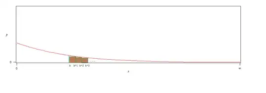

My hint is, apply logarithm to break the LHS into a sum, and evaluate the sum by an integral.

For such evaluation about a sum concerning consecutive integers there is a quite useful trick (although not an exact evaluation, yet useful at most times, esp. in proving an inequality). First we need to know what the plot of $y=\ln(1+(1/2)^x)$ looks like. So I made a plot using Maple (see below). Obviously it is ever-decreasing and downward convex in $\mathbb R^{+}$. In fact, as you will later see, the only two things that matter in our evaluation is whether the function is an increasing or decreasing one and whether it is upward convex or downward convex, so we don't necessarily have to turn to Maple, calculating $y'$ and $y''$ by hand will also do. Well, that depends on whether you have a plotting software at hand.
Ok, so back to the subject, we are now evaluating one term, like $\ln(1+(1/2)^{k+1})$, in the LHS sum. Note that what we are to prove is a "$<$" inequality. Therefore, we naturally want to make a "$<$" evaluation. From the plot, it is very geometrically clear that $\ln(1+(1/2)^{k+1})$ just amounts to the area of a "block" with the width $1$ and the height $\ln(1+(1/2)^{k+1})$, which is exactly the leftmost block shown in the plot. And likewise, the next term $\ln(1+(1/2)^{k+2})$ amounts to the second block from the left......
Now let the "first block" be the one from $0$ to $1$, say, the "k-th" block from $(k-1)$ to $k$. Since all the blocks are strictly below the function's plot, we have
$$LHS<\int_{0}^{+\infty} \ln(1+(1/2)^x)dx $$
where the RHS, calculated by Maple, is $1.18657$. Oops, that doesn't look like what we want! But don't worry, it just means that our evaluation is much too surplus. We can get rid of the "overflow" easily just by putting our evaluation some blocks forward. Try starting our "block evaluation" from $x=10$, say, from the eleventh term $\ln(1+(1/2)^{11})$
$$LHS<\displaystyle\sum_{r=1}^{10}\ln(1+(\frac{1}{2})^r)+\int_{10}^{+\infty} \ln(1+(1/2)^x)dx$$
