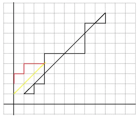

Next, we consider the paths that DO go above the line $y=x$ (the bad paths). We note that for each such path, there exists a unique first upstep that brings the path above the line (it could even be the first step). We draw a line of slope $1$ passing through the end of this unique up step, and reflect the path up to that step about the line, giving a path from $(-1,1)$ to $(n,n)$. (See picture)
A bad path reflected after its first bad upstep
Now, we've shown that any bad path can be mapped onto a path from $(-1,1)$ to $(n,n)$. It is indeed true (but you should convince yourself of this) that any path from $(-1,1)$ to $(n,n)$ can be mapped onto a bad path from from $(0,0)$ to $(n,n)$. Hence, there are the same number of bad paths from from $(0,0)$ to $(n,n)$ as the number of all paths from $(-1,1)$ to $(n,n)$, which by the argument above is ${2n}\choose{n-1}$=${2n}\choose{n+1}$.

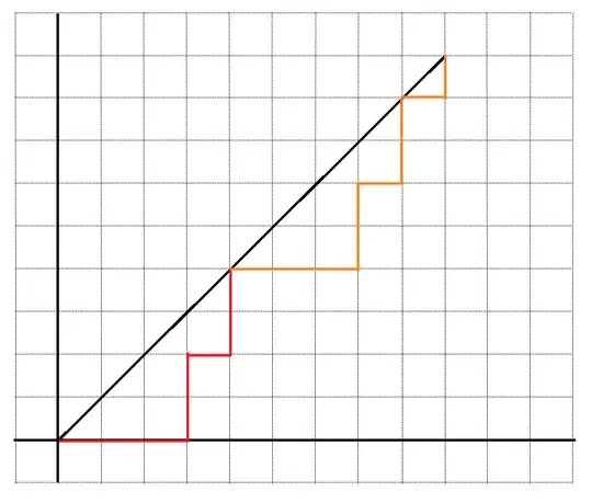

If you are comfortable with generating functions, we can let $g(x)$ be the generating function for paths that stay below the line $y=x$. Let us call paths that stay below the line good paths. Then we can note that each path that is below the line $y=x$ can be broken into two after the first return to the axis. A Dyck path broken into the the part up until the first return to the axis, and another Dyck path
Now if we let $x^{1/2}$ be the weight of each step, then the first part of the path can be written as $x g(x)$, as it is a right step ($x^{1/2}$), followed by a good path ($g(x)$), followed be an up step ($x^{1/2}$). The second part of the path is just another good path ($g(x)$). The only path that cannot be written this way is the lone good path that does not start with a right step, namely, the empty path from $(0,0)$ to $(0,0)$, who's generating series is just $x^0=1$. Hence we have that $$g(x) = x g(x) \cdot g(x)+1=x g(x)^2+1 $$
