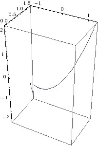

Is there a name for the curve given by the parametrization $\{(t,t^2,t^3); t\in\mathbb R\}$?
Here is a plot from WA.

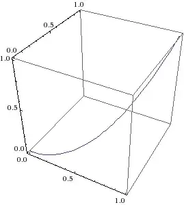

An another plot for $t$ from $0$ to $1$.
