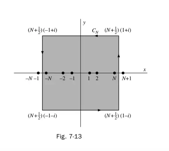

This my question: we need to consider a $f(z)$ such that,
$$\frac{1}{2\pi i} \cdot\oint_{C_N} f(z) dz = \text{something (maybe residue)} + \sum_{n=1}^{N} \frac{1}{(n+1)(n+2)^3}$$
How do we do this? I believe we consider, a square with vertices:
contour
We also need to prove that as $N \to \infty$ that $\displaystyle \oint_{C_N} f(z) dz \to 0$
Can someone give me an idea?

This approach will not get you the sum you want. Let's see why.
The contour $C_N$ you show encloses simple poles at all of the integers except at $z=-1$, which has a double pole, and $z=-2$, which has a quadruple pole. I will not compute them here as I do not need to in order to make my point.
We may safely assume that the contour integral
$$\oint_{C_N} dz \frac{\pi \cot{\pi z}}{(z+1)(z+2)^3} $$
vanishes as $N \to \infty$. By the residue theorem, however, this contour integral is $i 2 \pi$ times the sum of the residues of the poles inside $C_N$. Thus, we have
$$\sum_{n=-\infty}^{-3} \frac1{(n+1)(n+2)^3} + \sum_{n=0}^{\infty} \frac1{(n+1)(n+2)^3} + \left [\frac{d}{dz} \frac{\pi \cot{\pi z}}{(z+2)^3} \right ]_{z=-1} + \frac1{3!}\left [\frac{d^3}{dz^3} \frac{\pi \cot{\pi z}}{z+1} \right ]_{z=-2}= 0$$
Note that the first sum does not match up with the second sum. It is easier to see this after rewriting the first sum by subbing $n \mapsto -n$ to get
$$\sum_{n=3}^{\infty} \frac1{(n-1) (n-2)^3} = \sum_{n=0}^{\infty} \frac1{(n+1)^3 (n+2)} $$
Thus, we find that the sum of two sums is equal to the residues at the poles...blah blah blah. But not the sum you seek.
