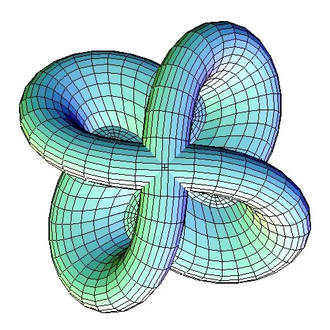

The geometric difference between a regular homotopy and an isotopy is the same as the geometric difference between an immersion and an embedding. Every embedding is an immersion but not vice verca (i.e. $\operatorname{Emb}(M, N)$ is usually a proper subset of $\operatorname{Imm}(M, N)$). At some point in the regular homotopy, one of the intermediate maps will be an immersion but not an embedding; for example, whenever the image of the sphere has self-intersection. One of the explicit regular homotopies between $f$ and $-f$ was given by Morin; halfway through the regular homotopy, the image of the sphere is Morin's surface (image below from Wikipedia) which has self-intersection, so it cannot be the image of an embedding.
$\hspace{26mm}$enter image description here
