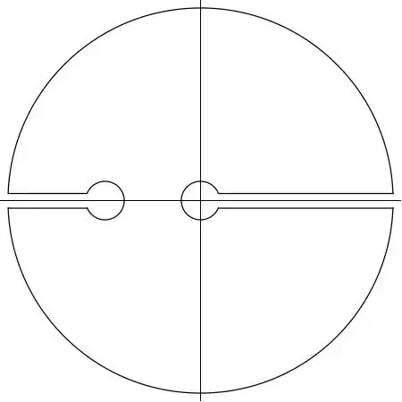

where $C$ is a keyhole contour of outer radius $R$ and inner radius $\epsilon$ as defined in the figure below:
That is, $C$ avoids the branch points at $z=0$ and $z=-1$. As demonstrated in the linked-to answer, each logarithm provides a jump of $-i 2 \pi$ across their respective branch cut. (The reason is due to the clockwise traversal around the branch point as the contour is traversed in the positive sense.) Because the integral over the arcs vanish as $R \to \infty$ and $\epsilon \to 0$, the contour integral is equal to
$$-i 2 \pi \int_0^{\infty} dx \frac{\log{(1+x)}}{x (1+x^2)} - i 2 \pi \int_{e^{i \pi}}^{\infty \, e^{i \pi}} dt \frac{\log{t}}{t (1+t^2)}$$
Note that the branch cut for $\log{z}$ is $[0,\infty]$ and, for the arguments $z$ fed into $\log{z}$, $\operatorname{arg}{z} \in [0,2 \pi)$. Also, the branch cut for $\log{(1+z)}$ is $(-\infty,-1]$ and, for the arguments $z$ fed into $\log{(1+z)}$, $\operatorname{arg}{z} \in (-\pi,\pi]$.
The second integral is evaluated using $t=u e^{i \pi}$, and is equal to
$$\begin{align}\int_1^{\infty} du \frac{i \pi +\log{u}}{u (1+u^2)} &= i \pi \int_1^{\infty} du \frac{1}{u (1+u^2)} + \int_1^{\infty} du \frac{\log{u}}{u (1+u^2)} \\ &= i \pi \int_0^1 du \frac{u}{1+u^2} - \int_0^1 du \frac{u \log{u}}{1+u^2}\\ &= i \frac{\pi}{2} \log{2} - \left [ \frac{d}{d\alpha}\sum_{k=0}^{\infty} (-1)^k \int_0^1 du \, u^{2 k +1+\alpha} \right ]_{\alpha=0} \\ &= i \frac{\pi}{2} \log{2} + \frac14 \sum_{k=0}^{\infty} \frac{(-1)^k}{(k+1)^2} \\ &= i \frac{\pi}{2} \log{2} + \frac{\pi^2}{48} \end{align}$$
The contour integral is also equal to $i 2 \pi$ times the sum of the residues at the poles $z_1=e^{i \pi/2}$ and $z_2=e^{i 3 \pi/2}$. This sum is equal to
$$\begin{align}\sum_{k=1}^2 \operatorname*{Res}_{z=z_k} \frac{\log{(1+z)} \log{z}}{z (1+z^2)} &= \frac{\log{(1+i)} \log{\left ( e^{i \pi/2}\right )}}{i (2 i)} + \frac{\log{(1-i)} \log{\left ( e^{i 3 \pi/2}\right )}}{(-i) (-2 i)}\\&= -\frac12 \left [\log{\left (\sqrt{2} e^{i \pi/4} \right )} i \frac{\pi}{2} + \log{\left (\sqrt{2} e^{-i \pi/4} \right )} i \frac{3\pi}{2} \right ]\\ &= -i \frac{\pi}{2} \log{2} - \frac{\pi^2}{8} \end{align}$$
Therefore, we may find the desired integral from
$$\int_0^{\infty} dx \frac{\log{(1+x)}}{x (1+x^2)} + i \frac{\pi}{2} \log{2} + \frac{\pi^2}{48} = i \frac{\pi}{2} \log{2} + \frac{\pi^2}{8} $$
or
$$\int_0^{\infty} dx \frac{\log{(1+x)}}{x (1+x^2)} = \frac{5 \pi^2}{48} $$
as was to be shown.
