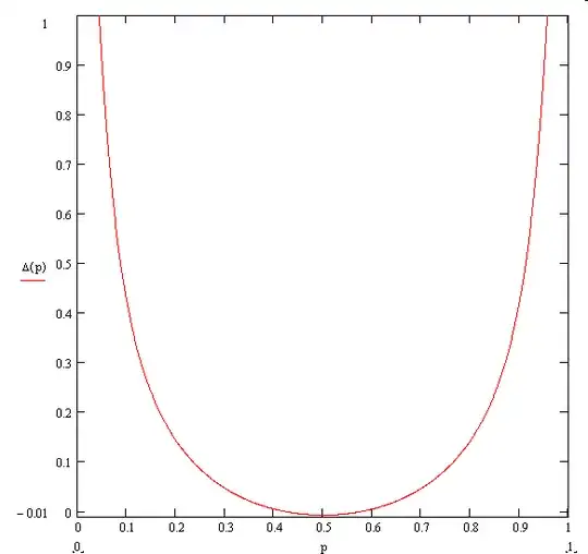

Put $$S_n(p)=\sum_{j=0}^n x_{n,p}^2(j).$$ My calculation evidence suggests that the sequence $\{\Delta_n\}$, where $$\Delta_n(p)=\sqrt{n} S_n(p) -\frac 1{\sqrt\pi}$$ pointwise converges on $(0,1)$ to a convex function $\Delta(p)$ such that $\Delta(1/2)=0$ and $\Delta(p)= \Delta(1-p)$ for each $p$. Any suggestions about the function $\Delta(p)$?
I add graphs of functions $\Delta_n$ suggesting the convergence:
$\Delta_{10}$:
$\Delta_{100}$:
$\Delta_{1000}$:
