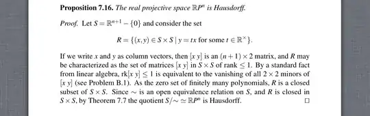

For the Hausdorff property,
For your first question note that the images of the $U_i$ in the quotient are open sets, and that these form an open cover. Your maps $\varphi_i$ pass to the quotient and induce homeomorphisms onto their images (write down an inverse map!). If you need more details, please tell me so.
Let $\pi : \mathbb{R}^{n+1} \backslash \{ 0 \} \to \mathbb{R}P^n$ denote the quotient map. In my answer to Real projective space is Hausdorff: is this proof correct? you will find a proof that
a) $\mathbb{R}P^n$ is Hausdorff.
b) The restriction $\hat{\pi} = \pi \mid_{S^n} : S^n \to \mathbb{R}P^n$ is also a quotient map (where $S^n \subset \mathbb{R}^{n+1}$ denotes the standard $n$-sphere).
I guess you know that that $S^n$ is an $n$-manifold. To show that also $\mathbb{R}P^n$ is one, it therefore suffices to show that each sufficiently small $U \subset S^n$ is mapped by $\hat{\pi}$ homeomorphically onto an open $V \subset \mathbb{R}P^n$.
Let $x \in S^n$ and $\varepsilon > 0$. Then $U = \{ y \in S^n \mid \lVert y - x \rVert < \varepsilon \}$ is open in $S^n$ and for sufficiently small $\varepsilon$ we see that $\hat{\pi}$ maps the closure $\overline{U}$ bijectively onto $\hat{\pi}(\overline{U})$. But $\overline{U}$ is compact so that this mapping is a homeomorphism. Hence also $U$ is mapped homeomorphically onto $\hat{\pi}(U)$. Clearly $\hat{\pi}(U)$ is open in $\mathbb{R}P^n$ (consider $\hat{\pi}^{-1}(\hat{\pi}(U))$).
Paul Frost
