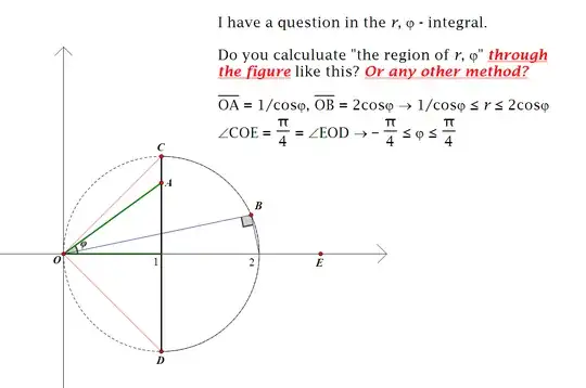

This picture is for asking to Christian Blatter
(I am really sorry, if I bother you guys for this picture.)

  • That's exactly the figure I had made for myself. – Christian Blatter Dec 30 '14 at 13:48
I shall introduce new coordinates (again denoted by $x$, $y$) such that the point $(0,-1)$ becomes the origin, and your vertical axis is my horizontal axis. Your integral then appears as $$J:=\int_H{x-1\over x^2+y^2}\>{\rm d}(x,y)\ ,$$ where $H$ is the right half of the unit disk with center $(1,0)$. Introducing polar coordinates we obtain $$J=\int_{-\pi/4}^{\pi/4}\int_{1/\cos\phi}^{2\cos\phi}{r\cos\phi-1\over r^2} r\>dr\ d\phi\ .$$ Here the inner integral evaluates to $$(2\cos^2\phi-1)-(\log 2+2\log\cos\phi)\ .$$ We therefore get $$J=1-{\pi\over2}\log 2-4\int_0^{\pi/4}\log\cos\phi\ d\phi=1+{\pi\over2}\log 2-2 \>{\tt Catalan}\doteq0.256862\ ,$$ where ${\tt Catalan}$ is Catalan's constant ($\doteq0.915966$)
  • Thanks a lot!! But I have some question. Is this right manner, if I modify my question for asking to you?? (I'd like to upload a picture..) – user143993 Dec 30 '14 at 13:11
  • @user143993: When something is unclear in my answer, ask in a comment to it. For supplementary problems I suggest you update your question. – Christian Blatter Dec 30 '14 at 13:19
  • I update my question. Could you answer my question, please? Really thank you. – user143993 Dec 30 '14 at 13:26
  • and I'd (REALLY) like to know 'thinking process' for making $J$ (you have defined) – user143993 Dec 30 '14 at 13:29
  • $$$$ I'd REALLY like to know your 'thinking process' for making J (you have defined). Id est, what make you think this "NEW region H" from "the origin region D"?? – user143993 Dec 30 '14 at 13:56

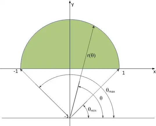

The integrand function $\frac{y}{x^2+(y+1)^2}$ suggest to put $$\left\{ \begin{align} x&=r\cos\theta\\ y+1&=r\sin\theta \end{align}\right. $$ so that $x^2+(y+1)^2=r^2$ and the Jacobian is $r$.
From $y\ge 0$ we have $y=r\sin\theta-1\ge 0$ that is $r\ge\frac{1}{\sin\theta}$ and from $x^2+y^2\le 1$ we have $$x^2+y^2=r^2\cos^2\theta+(r\sin\theta-1)^2=r^2-2r\sin\theta+1\le 1$$ and then $r(r-2\sin\theta)\le0$ so that $r\le 2\sin\theta$. So we have $$\boxed{ r_{\min}=\frac{1}{\sin\theta}\le r\le 2\sin\theta=r_{\max}} $$ For $y=0$ (i.e. $r\sin\theta =1$) we have $-1\le x\le 1$, that is $-1\le r\cos\theta\le 1$ and then $-1\le\tan\theta\le 1$; thus $$\boxed{ \theta_{\min}=\frac{\pi}{4}\le \theta\le \frac{3\pi}{4}=\theta_{\max}} $$
or $\frac{-\pi}{4}\le \theta\le \frac{+\pi}{4}$ if you prefer.
The figure help to show all we have done. enter image description here
So the integrand in polar coordinates becomes $f(r,\theta)=\frac{r\sin\theta-1}{r^2}$ and the integral becomes $$ \mathcal{I}=\int_{\theta_{\min}}^{\theta_{\max}}\int_{r_{\min}}^{r_{\max}} f(r,\theta)r\,\mathrm d r\,\mathrm d\theta= \int_{\frac{\pi}{4}}^{\frac{3\pi}{4}}\int_{\frac{1}{\sin\theta}}^{2\sin\theta}\left(\sin\theta-\frac{1}{r}\right) \mathrm d r\,\mathrm d\theta $$ The integral in $r$ is easy to evaluate $$\begin{align} \int_{\frac{1}{\sin\theta}}^{2\sin\theta}\left(\sin\theta-\frac{1}{r}\right) \mathrm d r &= \left[\sin\theta\, r-\log r\right]_{\frac{1}{\sin\theta}}^{2\sin\theta}\\ &=\sin\theta\left[2\sin\theta-\tfrac{1}{\sin\theta}\right]-\left[\log(2\sin\theta)-\log\left(\tfrac{1}{\sin\theta}\right)\right]\\ &=-\cos(2\theta)-\log\left(2\sin^2\theta\right) \end{align} $$ Then the integral in $\theta$ is $$\begin{align} \int_{\frac{\pi}{4}}^{\frac{3\pi}{4}} \left[-\cos(2\theta)-\log\left(2\sin^2\theta\right)\right]\mathrm d \theta &= \left[-\frac{1}{2}\sin(2\theta)\, \right]_{\frac{\pi}{4}}^{\frac{3\pi}{4}}-\int_{\frac{\pi}{4}}^{\frac{3\pi}{4}} \log\left(2\sin^2\theta\right)\mathrm d \theta=1+J \end{align} $$ where $$ J=-\int_{\frac{\pi}{4}}^{\frac{3\pi}{4}} \log\left(2\right)\mathrm d \theta-\int_{\frac{\pi}{4}}^{\frac{3\pi}{4}} \log\left(\sin^2\theta\right)\mathrm d \theta= -\frac{\pi}{2}\log 2-2C+\pi\log 2=\frac{\pi}{2}\log 2-2C $$ observig that $$\begin{align} -\int_{\frac{\pi}{4}}^{\frac{3\pi}{4}} \log\left(\sin^2\theta\right)\mathrm d \theta &= -\int_{-\frac{\pi}{4}}^{\frac{\pi}{4}} \log\left(\cos^2\theta\right)\mathrm d \theta=-2\int_{0}^{\frac{\pi}{4}} \log\left(\cos^2\theta\right)\mathrm d \theta\\ &=-4\int_{0}^{\frac{\pi}{4}} \log\left(\cos\theta\right)\mathrm d \theta=-4\left(\frac{C}{2}-\frac{\pi}{4}\log 2\right)\\ &=-2C+\pi\log 2 \end{align} $$ where $C$ is the Catalan's constant (see for exaple here).
Finally we have $$\large\color{blue}{ \mathcal I=1+\frac{\pi}{2}\log 2-2C} $$
