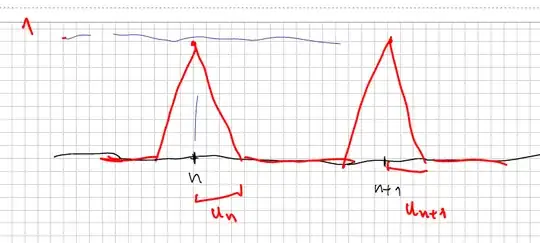

27
this is not true
you can construct a function easily like this:function graph
so $\int_{a}^{\infty}|f(x)| = \sum{u_n}$ starting from n0 such that $u_{n0-1} < a \leq u_{n0}$
so take any $u_n$ such that $\sum{u_n}$ converges
