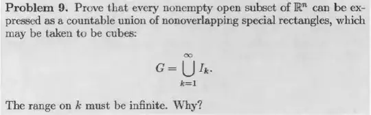

Here's some additional context since there's quite a bit of discussion on the problem. The problem as originally written in Chapter 2 of Lebesgue Integration on Euclidean Space by Frank Jones reads: enter image description here

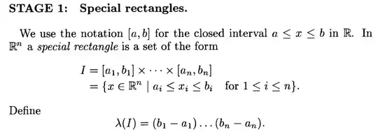

Of course, we need to know what a special rectangle is. This is defined as follows (essentially just a closed rectangle): enter image description here

  • @bof, I suppose the problem could be wrong, but I am quite sure that I am quoting the problem correctly. It is from the book Lebesgue Integration on Euclidean Space by Frank Jones. It is Chapter 2 Section A Problem 9. – mathjacks Dec 24 '14 at 01:32
  • he defines rectangles to be nonoverlapping if their $interiors$ are disjoint (see page 28) – Alain Aug 13 '17 at 03:43
