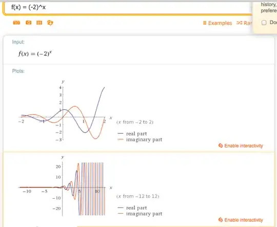

Wolfram Computes the result using the principal roots
wolfram output

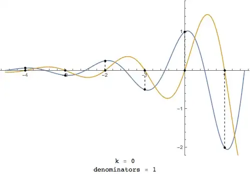

The following is a variation of the visualization of the function $x^x$ that I described in this answer.
It's not clear to me how to explain it to middle school kids, though. Specifically, if you want to explain the WolframAlpha output to middle schoolers, then they've got to know that $$(-2)^x = e^{x\log(-2)} = e^{x(\log(2) + i\pi)} = 2^x e^{xi\pi} = 2^x(\cos(\pi x)+i\sin(\pi x).$$ Note that this last expression can be computed in terms of real trig and exponential functions. I'm guessing that most middle schoolers aren't quite there yet but, assuming your students are, then we can efficiently compute all kinds of values of your function. For example, what's $(-2)^{1/4}$? Well, $$(-2)^{1/4} = \sqrt[4]{2}(\cos(\pi/4)+i\sin(\pi/4) = \sqrt[4]{2}\left(\frac{1}{\sqrt{2}} + \frac{i}{\sqrt{2}}\right) = \frac{1}{\sqrt[4]{2}}+\frac{i}{\sqrt[4]{2}}.$$ We can do your $(-2)^{\pi}$, as well. $$(-2)^{\pi} = 2^{\pi}(\cos(\pi^2)+i\sin(\pi^2)) \approx -7.96618 - 3.7974 i.$$

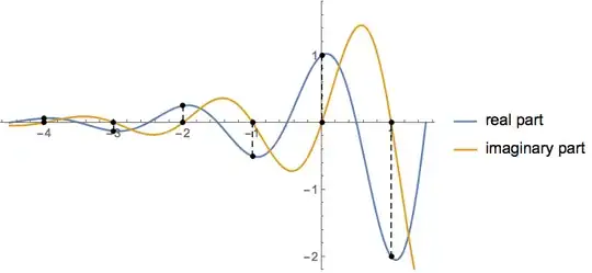

Now, if we can accept this, the Wolfram Alpha plot is then a simple matter of plotting the real part of $f(t)=(-2)^t$ together with the imaginary part, both on the same set of axes.
Note that the imaginary graph crosses the horizontal axis right at the integers and this accounts for some of the real values of $(-2)^x$. What about the other values? Well, it turns out that the complex logarithm has many branches corresponding to the fact that the exponential function is periodic in the complex direction. This can be accounted for in our formula for $(-2)^x$ by writing $$(-2)^x = e^{x\log(-2)+2ki\pi} = e^{x(\log(2) + i\pi+2ki\pi)} = 2^x e^{i(2k+1)\pi x} = 2^x(\cos((2k+1)\pi x)+i\sin((2k+1)\pi x)).$$ Thus, we have a different plot for each $k$. If we plot these in sequence, we get something like so:

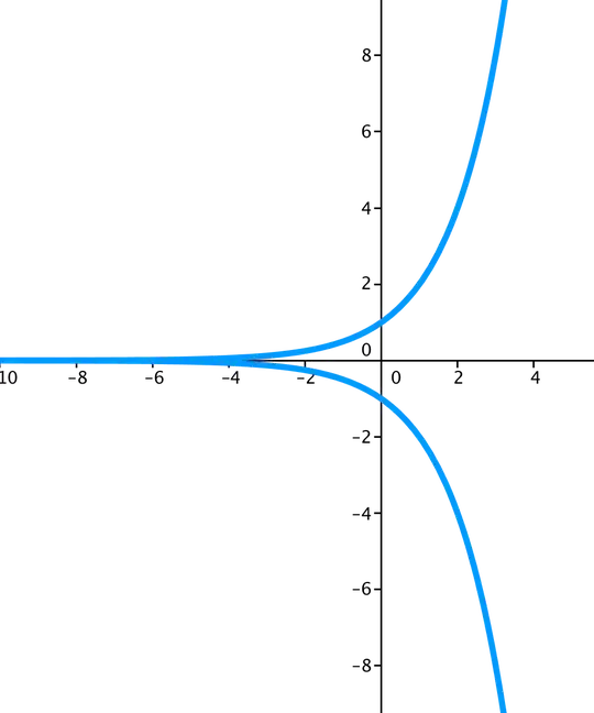

If we plot just the dots for a number of these, we get an image that is something like your blue graph.

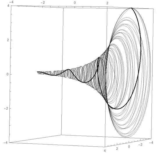

As in my other answer, we can parametrically plot each curve $(t,\text{Re}(f_k(t)),\text{Im}(f_k(t)))$ in 3D. The result looks like so:
The thick path is the so-called principal branch, where $k=0$. The other paths are other branches. From this perspective, the points where $f(t)$ might be thought of as real arise as points where one of those paths punctures the $xy$-plane.

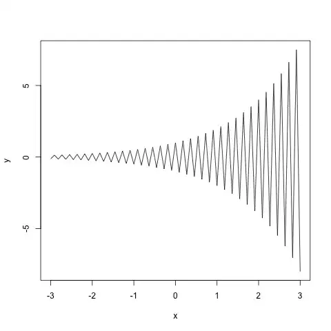

Here's a line plot of $(-2)^x$ for $x$ rational with denominator $11$. That is, the plotting system plotted points and then drew lines between consecutive ones.

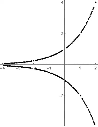

Here's a point plot of $(-2)^x$ for $x$ rational with denominator $11$. That is, the plotting system only plotted the points and didn't draw lines between them.
I made these by explicitly telling the plotting program only to plot this for $x$ rational with denominator $11$. In fact, the plotting system I used wanted to return NaN (not a number) for this, as discussed in (2) above, so I had it raise $2^x$ and then put in the appropriate sign.

Which branch is it taking? It's taking $f(z) = e^{z \log(-2)}$ and then using the principal branch of the complex logarithm. Here's a WolframAlpha plot of that, which is identical to yours (except it plots it with different bounds by default). Notice it's given you which branch it's chosen: $f(z) = e^{z (\log(2) + i\pi)}$.
For $z = x$ real, this is $e^{x\log(2)}e^{xi\pi} = 2^x (\cos(x\pi) + i \sin(x\pi)) = 2^x\cos(x\pi) + i\, 2^x\sin(x\pi)$, which explains the oscillatory behavior of the real and imaginary parts.
The other branches of the complex logarithm are given by adding $2\pi i$, as in $e^{z (\log(2) + i\pi + 2\pi i k)}$ for any integer $k$. When $z = m/n$ is rational with odd denominator, if we use exactly the $k$ such that the denominator is $n = 2k+1$ then we get $e^{\frac{m}{n} (\log(2) + (2k+1) i\pi)} = e^{\frac{m}{n} \log(2)} e^{m i \pi} = 2^{m/n} (-1)^m$. This is the branch which I used for plotting above (with $n = 11$ and hence $k = 5$) and is either positive or negative depending on whether $m$ is even or odd. In fact it's perfectly continuous in the complex plane (away from its branch cut), and just oscillates very quickly because of the $2k+1$ factor. If we change the denominator to a different odd number, though, we're changing $k$, and it's no longer the same branch which explains why the function we'd want to plot oscillates infinitely often back and forth between positive and negative values and is not continuous.
