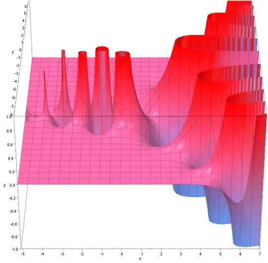

Let's start with an illustration of $\;\Im\left(\Gamma\left(x+iy\right)\right)\,$ to show our case $x=\frac 12$ in context : Im Gamma in complex plane

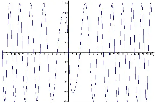

The relation $\left|\Gamma\left(\frac 12+iy\right)\right|=\sqrt{\dfrac{\pi}{\cosh(\pi\,y)}}\;$ found there allows us to 'rescale' the function so that the zeros become visible (else the oscillations would disappear quickly from the exponential decay far from $y=0$ as you may see in the previous picture).
Representation of $\;\Im\left(\Gamma\left(\dfrac 12+i\,y\right)\sqrt{\dfrac{\cosh\left(\pi\,y\right)}{\pi}}\right)$ : zeros of Im Gamma
with the first non negative zeros approximately given by $y_k$ in : \begin{array} {lll} k&y_k&a_k\\ \hline 0&0&0\\ 1&2.702691117402403870165565853&2.718281828\\ 2&5.053344767849197367797351047&5.058444527\\ 3&6.821889695106635313202928274&6.825074237\\ 4&8.373032938914556281390088770&8.375376509\\ 5&9.797707517468851913880784837&9.799572037\\ 6&11.13617463421067206562439664&11.13772771\\ 7&12.41062737183439804026853637&12.41196089\\ 8&13.63490243932245059948493022&13.63607244\\ \end{array}
(of course the negative solutions are symmetrical and... you would have obtained the same solutions using Wolfram alpha !)
