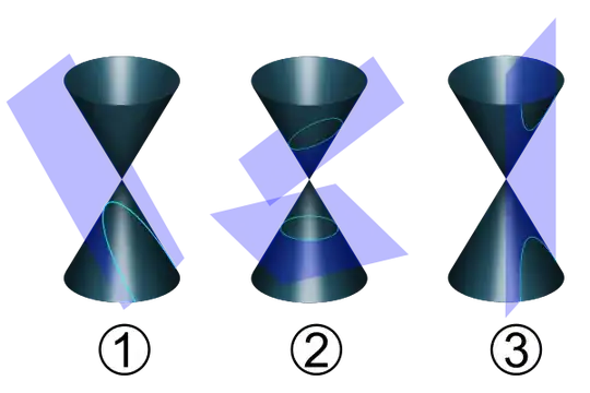

I have not been able to find a proof that the following definitions are equivalent anywhere, thought maybe someone could give me an idea:
  1. A parabola is defined geometrically as the intersection of a cone and a plane passing under the vertex of a cone that does not form a closed loop and is defined algebraically as the locus of points equidistant from a focus and a directrix.
  2. An ellipse is defined geometrically as the intersection of a cone and a plane that passes under the vertex and forms a closed loop and is defined algebraically as the locus of points the sum of whose distances from two foci is a constant.
  3. A hyperbola is defined geometrically as the intersection of a double cone and a plane that does not pass under the vertex and is defined algebraically as the locus of points that have a constant difference between the distances to two foci.
Picture of the geometric definitions: enter image description here

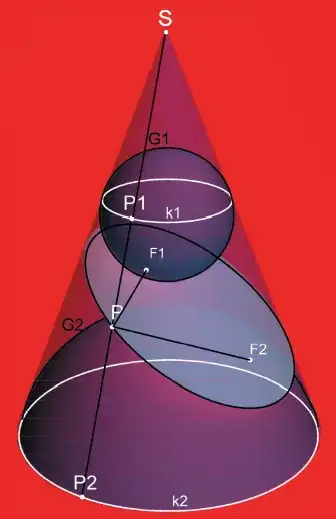

All of these can be proved by using Dandelin spheres. And Dandelin spheres can also be used to prove that the intersection between a plane and a cylinder is an ellipse.
Dandelin spheres
Both spheres in this picture touch but do not cross the cone, and both touch but do not cross the cutting plane. The points at which the spheres touch the plane are claimed to be the two foci. The distance from $P_1$ to $P$ must be equal to that from $F_1$ to $P$ because both of the lines intersecting at $P$ are tangent to the same sphere at $P_1$ and $F_1$ respectively. Similarly the distance from $P_2$ to $P$ equals that from $F_2$ to $P$. It remains only to see that the distance from $P_1$ to $P_2$ remains constant as $P$ moves along the curve.
For the hyperbola, the two spheres are in opposite nappes of the cone. For the parabola, there is only one Dandelin sphere, and the directrix is the intersection of the cutting plane with the plane in which the sphere intersects the cone.
