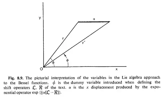

Bessel's equation seems to be saying: find a function in the plane such that when we shift it right, then shift it back left again, all locally (i.e. differentially) in polar coordinates, we get the same function:
(c.f. Killingbeck, Mathematical Technique's and Applications, sec. 8.21).

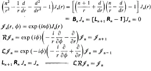

The idea is to take Bessel's equation, factor it, add an extra variable to make the factors parameter independent so that they become elements of a Lie algebra, identify the meaning of those factors, in this case notice the Lie algebra factors are translations in polar coordinates, and realize it's just a differential expression of a symmetry.
Bessel's equation arises from $L R v = v$ when you express $L$ & $R$ in polar coordinates. It makes sense to express them in polar coordinates since Bessel arises from separating the Laplacian assuming cylindrical symmetry, and the $LRv = v$ assumption (not $LRv = w$) is motivated by the symmetry of the Laplacian.
Using this idea we can, for some reason, actually solve Bessel's equation with a picture!:

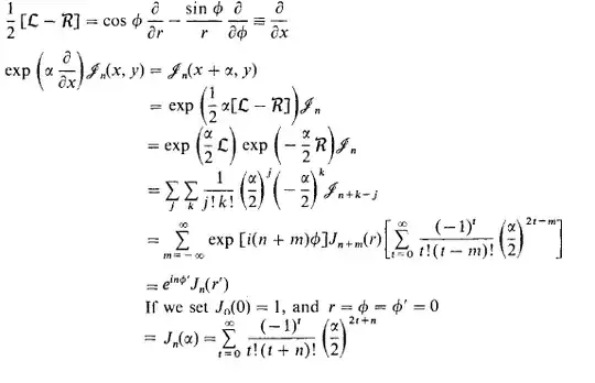

We just want to shift $\mathcal{J}_n(r,\phi)$ in the x-direction using the operator $e^{a\tfrac{\partial}{\partial x}}$ expressed in polar coordinates: $e^{\tfrac{a}{2}(\mathcal{L}-\mathcal{R})}$ and realize it will be equal to $\mathcal{J}_n(r',\phi')$:
So the last line comes from dragging all this to the origin and putting it along the x-axis, here we see the geometric meaning of Bessel functions!
(I am not yet completely sure how we link this calculation to the matrix representation of the Euclidean Group $E_2$
$$ g(x,y,\theta) = \left( \begin{array}{ccc} \cos(\theta) & - \sin(\theta) & x \\ \sin(\theta) & \cos(\theta) & y \\ 0 & 0 & 1 \end{array} \right)$$
Sadly, vaguely we can see it represents planar motions, and this is all linked to representation theory, but it's not fully clear to me how exactly).

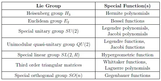

The question is: Is there a similar, easy, unified, geometric exposition for the rest of these types of equations, analogous to [or a better version of] this one, such as those in the following list: enter image description here
It'd be great to understand these other equations, their formulation and solution, with a geometric interpretation like this one. Understanding the intuition behind those groups seems to be the key. If you you feel so inspired, please post your versions of these problems here.

  • I will try to post a full answer when I have time because I would have quite a lot to say, but yes indeed there is whole universe of nice interrelated interpretations. Although at some point, you loose the geometric interpretation because it becomes hard to visualize anything. What you showed are the basic intuitions that lead to the definition of Lie groups. In one sentence : all exactly solvable systems are essentially an instance of what you showed. Such systems are realizations of the associated symmetry algebra and the solutions are a representation. – G. Bergeron Dec 14 '16 at 16:45
