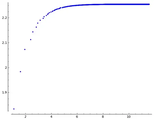

p = 104729 T = 0.000196636242440 R = 2.25441837672
T ~ 0.000196580221393
$R_p$ versus $\log p$ for primes $2$ through $10000$
where we plot the partial sums $R_p$ versus $\log p$ for $p\in\{p_2=3,\dots,p_{10000}=104729\}$. The last computed term (with $p=104729$) has contributed about $T_p/p \approx 0.000196636/104729 \approx 2\times 10^{-9}$ to $R_p \approx 2.2544184$, so the convergence seems adequate to offer the estimate as a fairly good lower bound. We also compare the computed (exact) value of $T_p=0.00019663624$ with the asymptotic estimate, $e^\gamma\frac{\log p}{p}=0.000196580221393$.
Notice that the plot above appears to repeatedly cross its "best fit" continuous approximation. This observation corresponds to the 1983 result of Guy Robin, and can be made more precise, yielding in the process another, presumably course analytic estimate for $S$ by way of the asymptotic Merten approximation $T_p \approx e^\gamma\frac{\log p}{p}$, whose corresponding sum can also be expressed analytically in terms of the prime zeta function: $$ S=1+\sum_p\frac{1}{p}\prod_{q\leq p}\left(1-\frac{1}{q}\right)^{-1} =1+\sum_p\frac{T_p}{p} \quad\implies $$ $$ S \approx 1-e^\gamma\zeta_{P}'(2) = 1+e^\gamma\sum_p\frac{\log p}{p^2} = 1+e^\gamma\sum_{k=1}^\infty\frac{\log p_k}{p_k^2}, \quad\text{where} $$ $$ \zeta_P(s) = \sum_p p^{-s} \implies \zeta_{P}'(s) = -\sum_{p}\frac{log p}{p^s} \quad\text{since}\quad \frac{d}{ds}e^{-s\log p} = e^{-s\log p}(-\log p). $$ Called from sage, mpmath calculates $\zeta_{P}'(2)=-0.93754825431584377$, yielding the "Merten" estimate $S\approx 1-e^\gamma\zeta_{P}'(2)=2.669841336296809$:

  • Yes, my previous calculation had mistakes in it. My corrected result is now consistent with, but poorer than, yours. The fact that your 2.25 is close to J.M.'s 2.22 is further encouragement to believe that you guys are right. –  Feb 05 '12 at 23:25
  • Interesting! I'll run my numerics on your reformulation of the sum and report back. :) – J. M. ain't a mathematician Feb 06 '12 at 01:06
  • After a few runs on fifteen thousand terms with convergence acceleration, the best estimate I have is $2.25443$, and that last $3$ is a bit iffy... – J. M. ain't a mathematician Feb 06 '12 at 01:39
